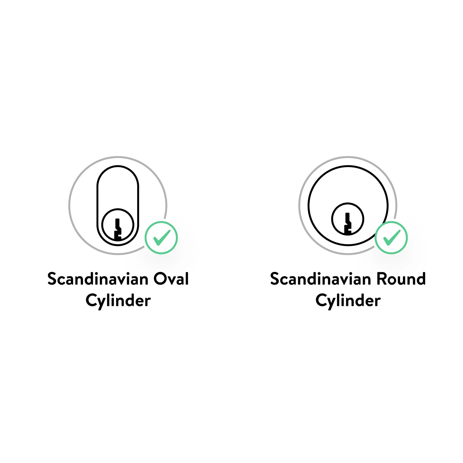

Compatible Cylinder Types
The Nuki Smart Lock Ultra Nordics is compatible with typical Scandinavian oval and round cylinders that have either a thumbturn or a key on the inside of the door.

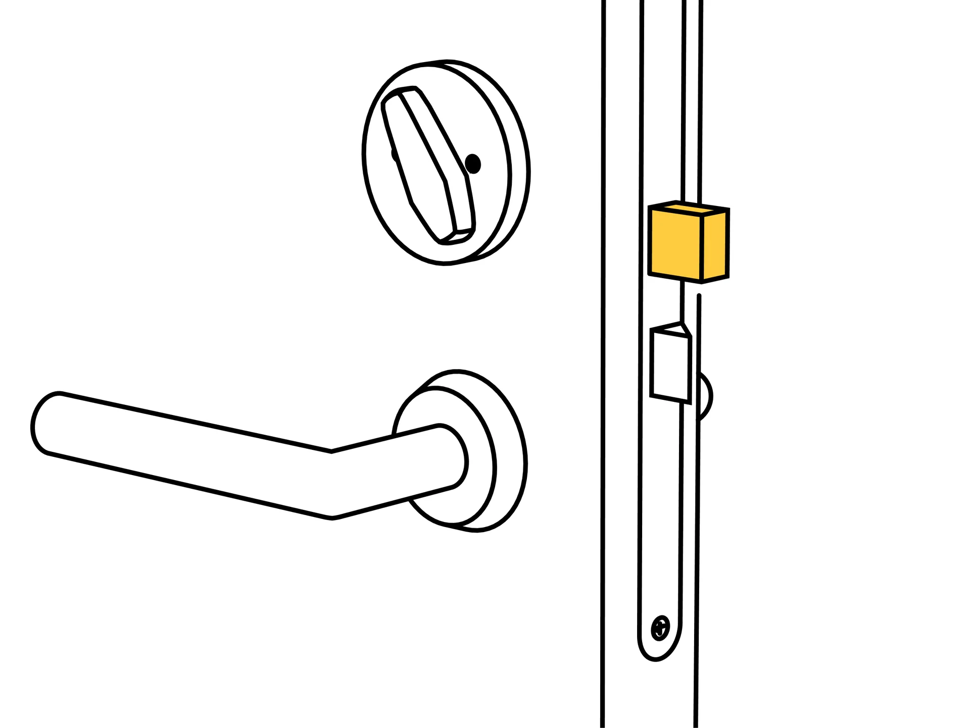

Deadbolt
Your cylinder needs to have a deadbolt. If you lock your door with your key or knob, for example, the deadbolt moves out to secure your door.
If you operate your door only by a latch, the Nuki Smart Lock is not compatible.
